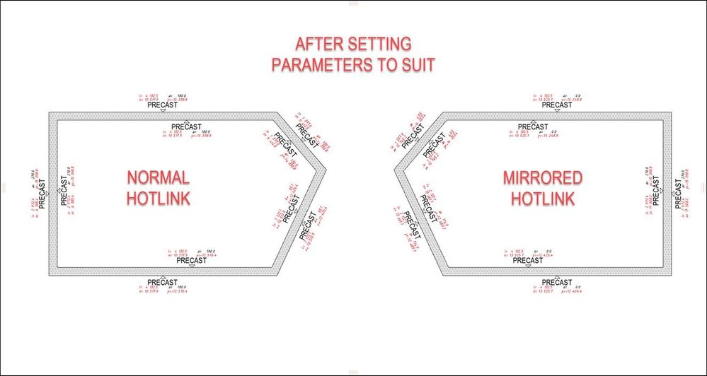

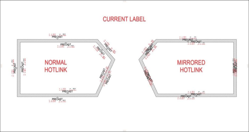

So, as stated earlier, what you need to do is add a boolean parameter that the user sets.  I have called this "hotlink_use" with the description of "Flip in mirrored hotlink".  Default OFF.
With a wall label, you also will probably have a parameter already where the user can choose which side of the wall the label appears.  In my part, this is a length parameter is called "flipmark1" (forgive the naming...I inherited the part), and can have a positive or negative value (a hard-coded distance for the label).
In the 2D script, I have a flag variable to use in my ADD2 statements depending on whether the label should be flipped or not.  This is named 'flip'.  I then run a series of tests to offset the label to the correct side of the wall.
In the below sample script, "hdepth" is the offset Y coordinate of the label.
flip = (flipmark1 >= 0)  ! Set flip to 1 or 0
IF hotlink_use & WALL_FLIPPED THEN
   flip = NOT(flip) ! Adjust for mirrored hotlinks (selected by user)
ENDIF
flip = flip-1*NOT(flip)  ! change 0 and 1 to -1 or 1
hdepth = A*(GLOB_SCALE/100) * flip
ADD2 0, hdepth
There will be more to your script, but this is the fundamentals of the transformations I've used.  I hope this has helped.Current.jpgNew.jpg
