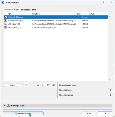

I try to reload it to reflect the changes I made. There are times when you can't do this...
