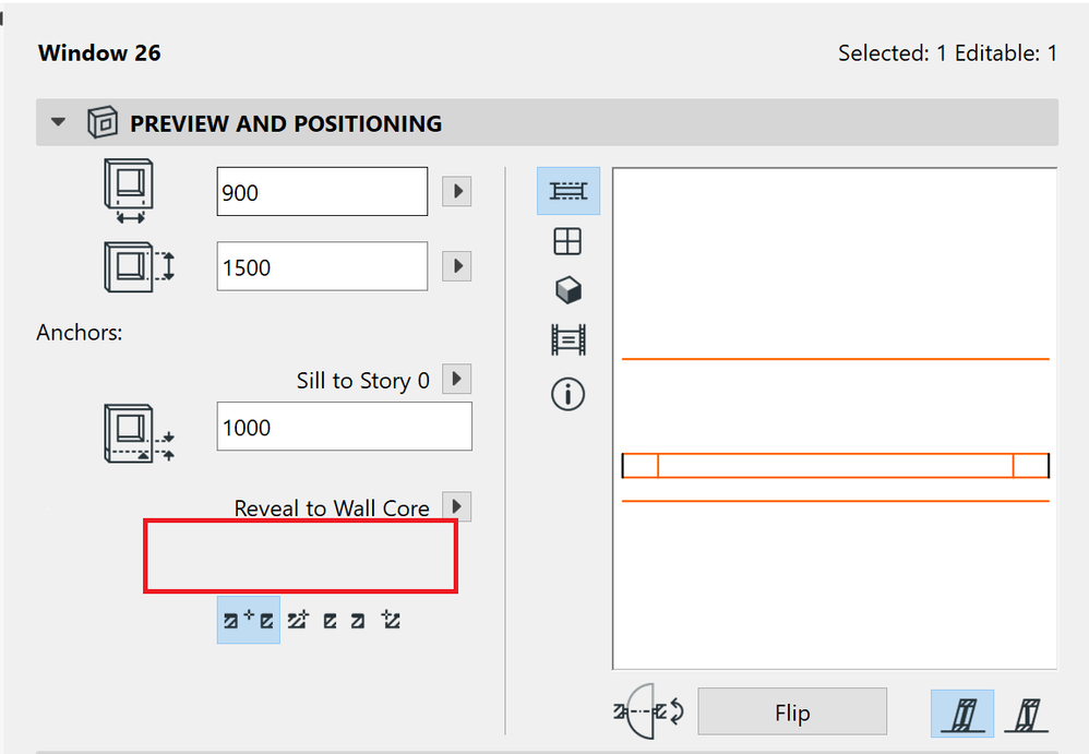

For the standard Archicad-windows the reveal to wall core can be set with an input field:
But in my self created window the input field is missing:
Does anybody know, what shall I change in the script to show the input-box?

I found out that ac_wido_hide_options=3 causes this behaviour.

Please check, if you have a HIDEPARAMETER command with the Parameter "ac_revealToWallCore"

There is no HIDEPARAMETER command with the Parameter "ac_revealToWallCore".

Here is the documentation of the available values: https://gdl.graphisoft.com/reference-guide/parameters-read-by-archicad#AC_WIDO_HIDE_OPTIONS_gdlgloba...
