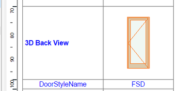

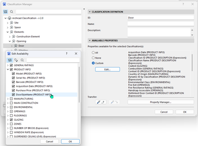

1. create DoorStyleName
2.
Displaying Properties with Labels | GRAPHISOFT GDL Center
I am trying to read this value from Marker.
Is it possible?
However, even if you look at the contents, the solution is not explained, so I would appreciate it if you could tell me where to start studying.

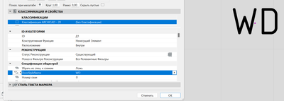

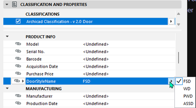

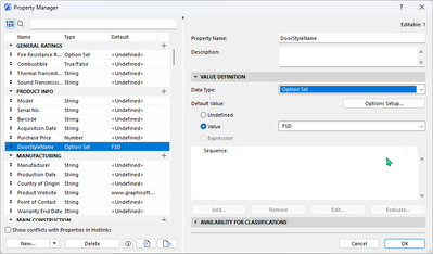

Do you mean the actual property which is set in the building component or do you mean the 4 Values from the options setup?
GS says: Only the actual property value can be accessed from GDL, the other choices aren’t visible.
Jochen Suehlo . AC12-29 . MAC OSX 26 . WIN11
LeeJaeYoung
I want to bring only the values I selected.

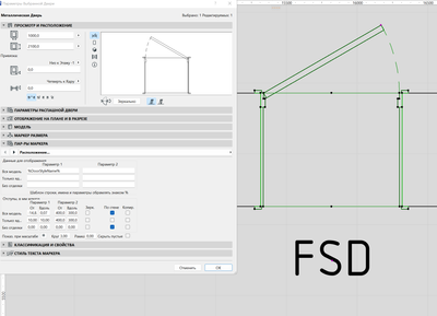

I think it will be easier to understand if you see the code. Please excuse me if I am not rude.
AC27 on window 11
