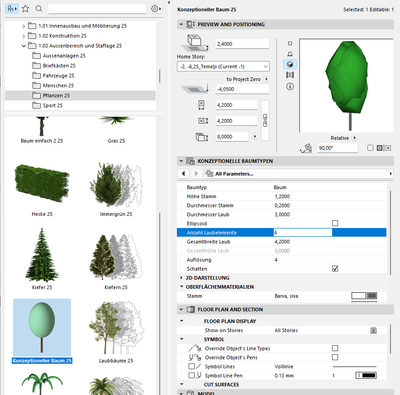

In the GER Library there is a Concept Tree object which is not that simple, but tweaking it's settings does allow to get similar results.

https://www.youtube.com/watch?v=b5_QGzv6RHQ&t=1493s the library / object linked in the video description will allow you to make something sort of similar.
There are some preset trees that you can change to use sphere shapes instead of warped planes, maybe lower the amount of shapes generated and change the surface material to something solid.

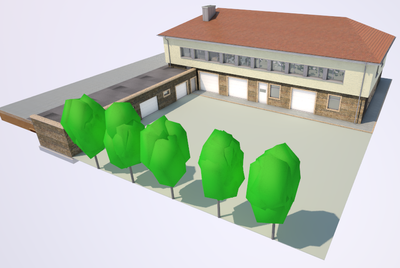

2022-12-13 03:16 PM
This is what came to my mind as well

Some quick try:

2022-12-14 08:55 AM
Have a look at the first 'panel' in the settings. That's where the amount of leaf objects are generated. You can try cutting the numbers in half to see if the results are still good enough.
It's going to look like an abstraction of a tree regardless, so I ussually go for a bit of artistic license. Then again, I'm no botanist, so I tend to go for 'good enough' quickly 🙂
