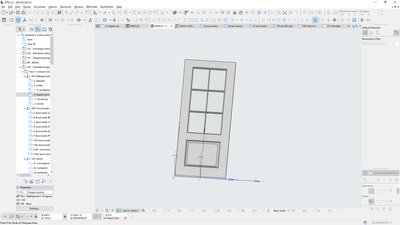

If you know a little bit of GDL, it is quite handy to have a collection of your own parametric door leafs.
It's mostly about making a lot of PRISM_ statements and some ADDZ if you have different thicknesses for panels and what not.
I set up parameters at the top with somewhat logical names, so I don't have to input the same dimensions over and over and to allow quick editing.
Bottom example uses Dutch words for the parameters, but I'm sure you can figure it out. You can paste this in the 3D script. The only real parameters I've added are 'mat1' and 'mat2' for the leaf and glass materials.
Save your object as a custom door leaf type and it should show up.
It should be a door leaf with a bottom panel and glazing divided in 2x3. Standard being 880x2.315 mm for the leaf here.
addx a/2
c=zzyzx
ddd=c
a=a
b=b
v=d
!mat1=e
!handtype=f
!g=g
!mat2=g
tsz=0
roehor=2
roever=3
links=0.139
rechts=0.139
bov=0.139
ond=0.190
tus=0.140
mid=0.850
glaslat=0.011
paneelrand=0.040
material mat2
prism_   15, ddd,
	-a/2, 0, 15,
	 a/2, 0, 15,
	 a/2, b, 15,
	-a/2, b, 15,
	-a/2, 0, -1,
	-a/2+links, ond, 15,
	 a/2-rechts, ond, 15,
	 a/2-rechts, mid-tus, 15,
	-a/2+links, mid-tus, 15,
	-a/2+links, ond, -1,
	-a/2+links, mid, 15,
	 a/2-rechts, mid, 15,
	 a/2-rechts, b-bov, 15,
	-a/2+links, b-bov, 15,
	-a/2+links, mid, -1
addz (ddd-0.012)/2
prism_  5, 0.012,
	-a/2+links+paneelrand,ond+paneelrand, 15,
	 a/2-(rechts+paneelrand),ond+paneelrand, 15,
	 a/2-(rechts+paneelrand), mid-tus-paneelrand, 15,
	-a/2+links+paneelrand, mid-tus-paneelrand, 15,
	-a/2+links+paneelrand,ond+paneelrand, -1
del 1
addz (ddd-0.006)/2
prism_ 10, 0.006,
	-a/2+links+glaslat, ond+glaslat, 15,
	 a/2-rechts-glaslat, ond+glaslat, 15,
	 a/2-rechts-glaslat, mid-tus-glaslat, 15,
	-a/2+links+glaslat, mid-tus-glaslat, 15,
	-a/2+links+glaslat, ond+glaslat, -1,
del 1
addz 0.003
kx = -a/2+links+glaslat
ky = mid+glaslat
dx = (a-(rechts+glaslat+links+glaslat)-glaslat*(roehor-1)) / roehor
dy = (b-(bov+glaslat)-(mid+glaslat)-glaslat*(roever-1)) / roever
for iy = 1 to roever step 1
	for ix = 1 to roehor step 1
		put kx, ky, 15,
			kx+dx, ky, 15,
			kx+dx, ky+dy, 15,
			kx, ky+dy, 15,
			kx, ky, -1
		kx = kx+dx+glaslat
	next ix
	ky = ky+dy+glaslat
next iy
prism_ 5+nsp/3, ddd-0.006,
	-a/2+links, mid, -1,
	use (nsp)
prism_ 10, ddd-0.006,
	-a/2+links+glaslat,ond+glaslat, 15,
	 a/2-(rechts+glaslat),ond+glaslat, 15,
	 a/2-(rechts+glaslat), mid-tus-glaslat, 15,
	-a/2+links+glaslat,ond+glaslat, -1
del 1
material mat1
addz ddd/2-0.007
for ii = 1 to roever*roehor step 1
	prism_ 5, 0.007,
		get (15)
next ii
del 1
