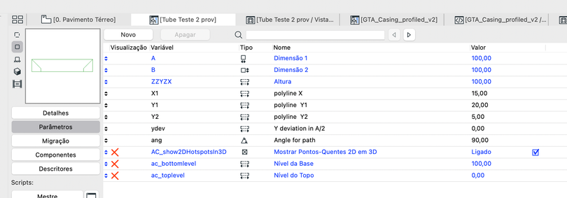

I was creating a door casing essentially made by a TUBE command which can read custom complex profiles from the project, then I faced this weird problem whose reason I still could not figure out.
So I created this simple object for testing purposes.
Notice the TUBE's profile seems to get inverted – as if the X coordinates of its profile are mirrored – if a subtle change in its path is applied. It happens when 'Y deviation in A/2' goes above a certain value, corresponding to an angle of aproximately 9º-10º with horizon.
I attached a short video showing the phenomenon when changing ' Y deviation' dinamically by an editable hotspot. Also attached an image of the parameters and the object (AC26).
Why is this happening and how can I avoid it?

Maybe the angle nets to go negative at some point during the tube?

I discovered these days, that TUBEa is in some cases much better then TUBE.
TUBE on top, TUBEa below.
Jochen Suehlo . AC12-29 . MAC OSX 26 . WIN11
runxel
Tubes are in some ways extremely limited, as we can see.
There comes an old GDL forum thread into mind.
To quote: "As you can read in the documentation, the W axis of a cross-section at each particular node of TUBE is tied to the Z axis."
Meaning: Tubes whose path does not stay in the XY-plane will deform and have issues to some degree. That's why rotating it later helps – in some cases.
In others, like here, only splitting the parts up will consistently help.
