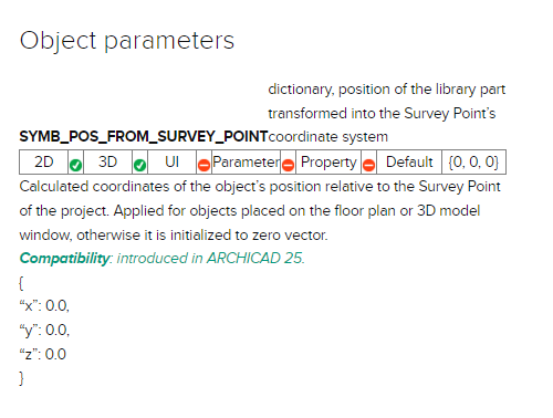

Hello, could you provide guidance on how to use the "SYMB_POS_FROM_SURVEY_POINT" parameter?
The default display format is {0, 0, 0},..
how should I write it if I want to represent the object's position (z)?
text2 0, 0, SYMB_POS_FROM_SURVEY_POINT
Writing it like this gives the message "Requires a representation of a character or numeric type."
I would appreciate it if you could share any examples or references that I can consult. Thank you.

oh. I've learned how to use it. 😅
Example
xx = SYMB_POS_FROM_SURVEY_POINT.x
yy = SYMB_POS_FROM_SURVEY_POINT.y
zz = SYMB_POS_FROM_SURVEY_POINT.z
