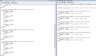

2022-10-25 10:57 AM - edited 2022-10-25 11:08 AM
That's great workaround, the idea behind using VALUES{2} is that the designers always change their mind on the therminology used in the parameters, so having control over the names on a centralized way has saved me huge amount of hours.
I will give it a spin to your solution to see how it adapts to my idea 👍.
What I ended up doing (not to my liking, keeping track of one change into so many places) is this:
