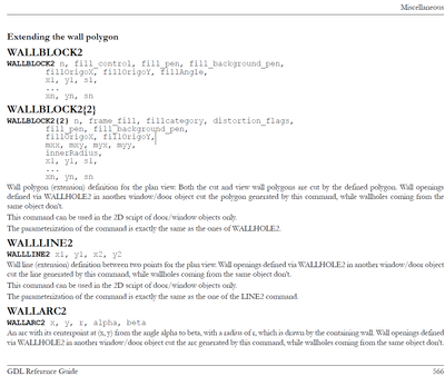

Hi all,
Anyone have some insight into how to get WALLBLOCK2{2} working? Trying to reference the Plaster Turn macro does not give much insight...
Not enough edges in generatrix.
WALLBLOCK2{2} 5, 2, 2,8 * (bLocalFill | bFitToSkinFill) + 32 * bFitToSkinFill + 128 * (bLocalFill & not(bFitToSkinFill)),
	ActSkinFillPen, ActSkinFillBkgPen,
	0,	0,
	-sin(dirAngle),-cos(dirAngle), -gs_fw_side_left*cos(dirAngle),gs_fw_side_left*sin(dirAngle),
	0,
	A/2,						0,			1,
	A/2 - gs_fw_side_left_i,	0,			1,
	A/2 - gs_fw_side_left_i,	-WIDO_SILL,	1,
	A/2,						-WIDO_SILL,	1,
	A/2,						0,			-1

I get the same error
	0,	0,
	0,
	A/2,						0,			1,
	A/2,						-WIDO_SILL,	1,
	A/2,						0,			-1
when i change the code to have the points not all overlapping then it works,(by adding 1 to opposite corners)

i think you just need to ensure that  all the coordinate points form a valid polygon.
if  WIDO_SILL =  0 or gs_fw_side_left_i  =  0 then it will not work.
also,
the  frame fill, fill pens etc should be set to what you want.
the default values of 0 will give you no visible fill, so set fills/edges/etc.
i hope that helps.
