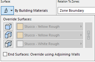

Why is there a different finish in 3d after the wallhole?
wallhole 5, 1,
-ac_wallhole_width/2, 0, 15,
ac_wallhole_width/2, ac_wallhole_height, 15,
-ac_wallhole_width/2, ac_wallhole_height, 15,
-ac_wallhole_width/2, 0, -1
I only used the function above.
However, the same door has a different finish.
Is what I did wrong?
Or is it something that needs to be followed up?

This is related to the wall's setting:
If the GDL doesn't specify a material, then the greyed settings will be used.
If GDL doesn't specify a wallhole, AC_HOLESIDEMATERIAL parameter will have an effect too.
To specify the material from GDL:
  • use status 0 with WALLHOLE, and SET MATERIAL before it.
  • don't use WALLHOLE, it has bugs with mirroring. Use WALLNICHE, where you can assign a material to each edge.
