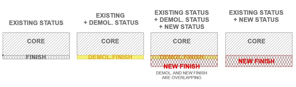

2022-11-07 12:09 PM
Hi James,
I mean like this overlapping Skins by Composites (or Component by Profile)- demolished and new status, if it could work it would be great
and also, what was mentioned there already, have the Modifiers for height for each Skins in Composites would be also great
