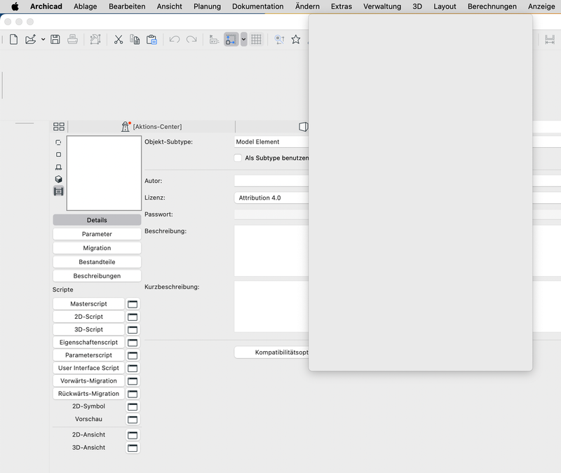

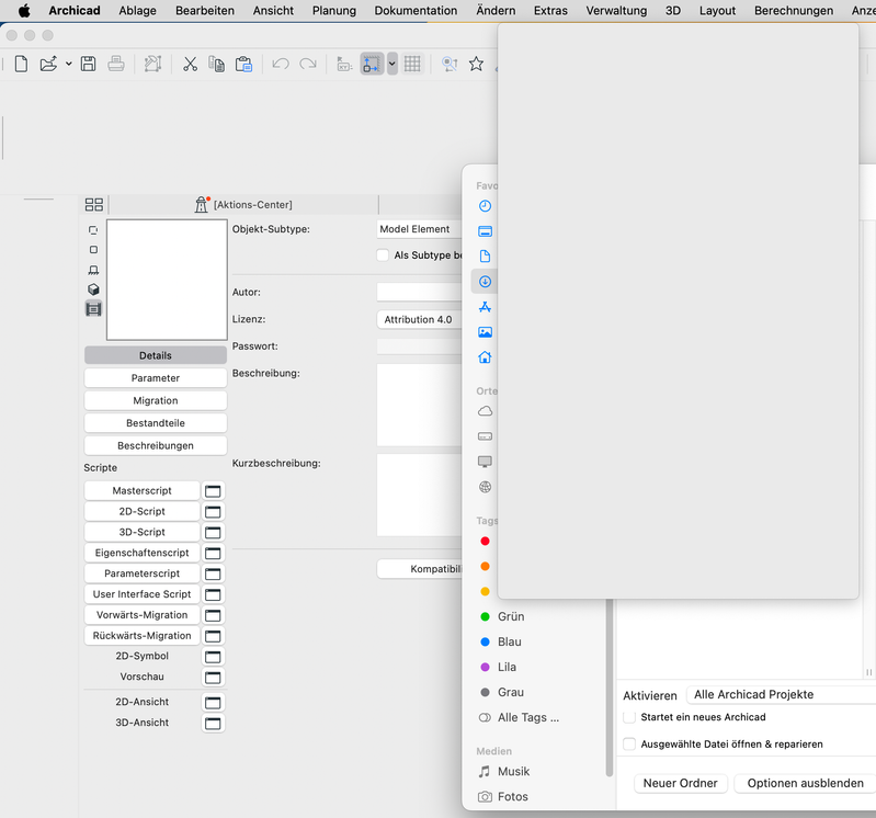

BUG
I tried to make an object, saved it. Wanted to open > empty field on the screen, always in the foreground.
> I had do close ArchiCAD and reopen the program..... 😞
> macOS Apple M2 Max, 64 GB RAM / Sequoia 15.5

Seems to be an issue with Tahoe .
https://community.graphisoft.com/t5/Installation-update/ArchiCAD-28-3-0-amp-MacOS-Tahoe/m-p/677103#M...
But I see your signature says Sequoia.
Is that up to date?
If so it may just be a 29 Mac issue, I have not head of it happening on Windows.
Definitly a Tahoe issue. Inadvertantly double-clicking on a menu item seems to trigger it. Quitting and re-opening solves the problem.

Yes, we currently use macOS Sequoia 15.5, not Tahoe.
With every new ArchiCAD version, always problems with macOS system updates (old or new ones....).
