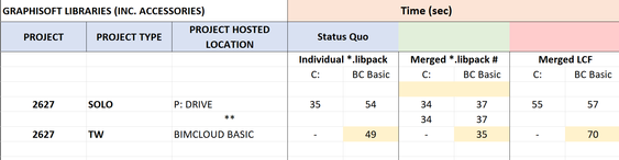

Hi all, thought I'd try a test and share my results (& pain) with anyone still struggling with this.
Here's what I tried: extracted ALL the Graphisoft *.libpacks and compiled them into:
Also tested whether the file being Solo or on Teamwork made a different
And where the Library was hosted: locally (our P: drive) or on BIIMCloud Basic - if I have time will do this on SaaS as well, but I suspect this will have longer load times)
This defeats some of the goals of the global libraries as the Merged LCF and libpack will no longer be able to do the live check (which I suspect may be part of the problem anyway). I also stripped out any mapping and translation files for simplicity
