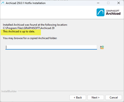

OK, just installed 29 and also the latest hotfix.
Then started Archicad.
Of course there are no goodie add-ons.
Closed Archicad.
Now I have installed the goodies and also the latest hotfix again, because they say to do that.
Restarted Archicad using default template and Work Environment.
All of the goodie add-ons are there in the menus.
I tried to re-apply the 29.0.1 Hotfix and the installer won't let me. This appears to be a new behavior as I'm sure I've re-applied patches in the past. I do not want to re-install AC29 again.

I am pretty sure the updates don't install if your program is already up to date.
Actually I just tried again and it says I am up to date.
Because I had installed the goodies, after the initial update, it knew something had changed and allowed me to run the update again.
The difference in goodie behaviour could be because you are Mac and I am Windows.
Maybe it was sorted for Windows and not Macs?
I have no way to test that though.
re-applying patches has been useful in the past. Doing this also fixed my Grasshopper connection problems once. Not sure hw re-applying a patch on top of itself would be a problem.
Hopefully this is fixed in the next update/hotfix.
