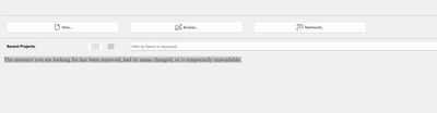

I have had many, MANY, of my clients run into a "reauthentication" notice when opening Archicad. It hit me today. It seems that AC can not re-authenticate on my computer now as well. Logging in simply gives the "resource you are looking for has been removed, had its name changed... etc. etc. etc."
I can quit and try again, but same results. I can skip authentication, but I know that starts a 7 day timer until I'm locked out.

Hi I am getting the same error, how was this issue resolved ?
Patrick M
I did figure out that if you log out (upper right corner), then back in, it will allow you to re-authenticate. The re-authenticate button does nothing
