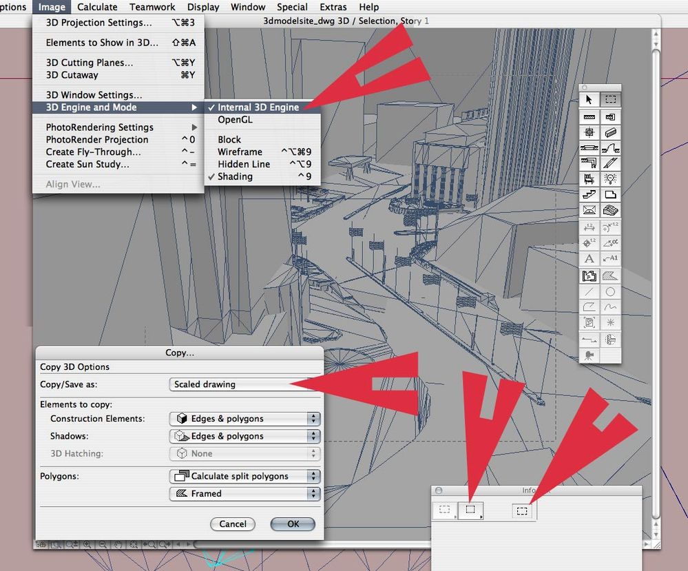

While the Photorendering window is independent of the 3D view size, attached is a screenshot of a method to create a vector and polygon view that can be pasted directly into Illustrator and resized infinitely.
This makes a large 3D window irrelevant.
Note that this is not for the OpenGL view from which only a pixel image can be copied.
