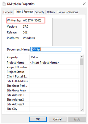

I know this does not help, but for the people on Windows, the Properties/Info&Preview gives this info. Yes, it is critical, since the projects are usually lasting longer than an Archicad version, and it is not always a good idea to change up...
