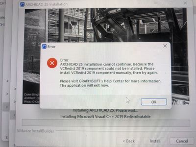

Cannot install AC 25 under Windows 11 (ARM) on M1 Max MAC
Roland68
THX for support!
MacBook Pro M1max with parallels and installing AC on windows11

Hi @Roland68
I'm actually surprised that you got as far as the error message that you show.  As you know, on an Apple ARM processor (M1, M1 Pro, M1 Max etc) - Parallels cannot run an Intel version of Windows - only the ARM version (which Microsoft has stated it has no intent of offering [yet] as an OS to the general public for such purposes - limiting the usefulness of Parallels Desktop on M1 chips).
While Windows 10 or 11 for ARM (vs Intel) support a virtualization of some Intel apps and code - they cannot fully support any arbitrary Intel Windows program.  The error message seems to indicate that the Visual C redistributable subsystem cannot be installed on ARM Windows.  That said, the ARCHICAD installer, being written only for Intel, would be looking for the Intel version of VCRedist.  You could see if you can find an ARM version of that library/subsystem on a Microsoft site, install it manually, and then try to install ARCHICAD again just in case it recognizes the ARM version during installation.   I doubt it though.
We will be waiting for many months for a native M1 version of ARCHICAD for MacOS as it is... I doubt seriously that Graphisoft will expend any resources trying to get a Windows version to run on ARM chips.
Is there a reason you are not simply running AC 25 under MacOS Monterey?

Roland68
Hi Karl!
Thank you very much for your prompt and detailed comment, now i understand the basic problem.
The reason for using parallels is, that we are used to work with Lumion since years and we are convinced that AC/Lumion ist the better solution than AC/twinmotion.
I will check if there is a VCRedist for ARM available, in the meanwhile I try an approach to Twinmotion....
Thanks!
Roland68
Lumion is only running on windows x64, maybe the next problem (not arm version)
