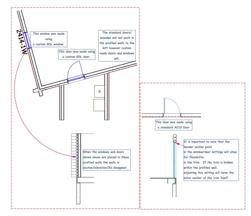

Folks,
After being so confident on my windows and doors working, I realized that in my half log profiled walls they did not. They placed into the walls fine but in section/Elevation/3D the walls themselves disappear leaving only the window/door in its place. Attached is a picture.

No bug, fixed one problem. I had a 1/64" gap between the logs to make the log profile show up on elevations instead of drawing them in later. This made each log it's own seperate wall. Silly on my part, I should have known it would do that. I still cannot get AC10 doors/windows to work in the walls but at least my Log home solutions windows/doors do now without making the walls disappear.
