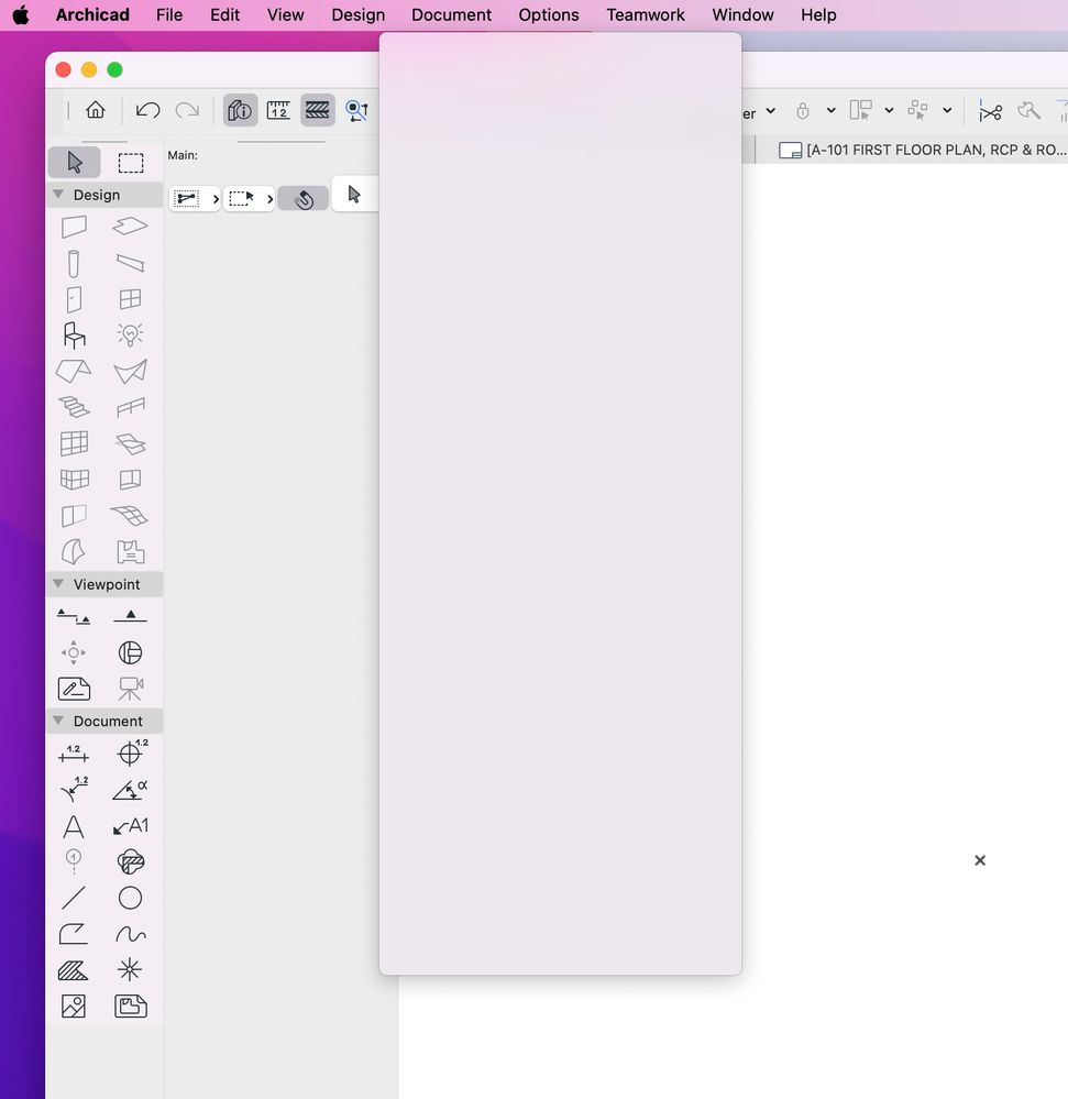

Please see photo attached. Occasionally when I use the drop down menu for "Documentation" and move off the menu, the menu remains. Currently I need to shut down Archicad and restart for it to go away. Are other users experiencing this? Any other suggestions to get the blank menu box to go away?
Thanks!

Just had this happen with the Enscape Menu and had to restart AC. At the time I had 2 AC sessions open.

This was reported before by other users as well, and it seems to be an issue with macOS Tahoe:
https://community.graphisoft.com/t5/Installation-update/Strange-Modal-Ghost-Dialog-Box/td-p/683569
https://community.graphisoft.com/t5/Installation-update/ArchiCAD-28-3-0-amp-MacOS-Tahoe/m-p/683422/h...

When I initially installed Tahoe I never saw the issue, nor did I see it in Sequoia, I am in Tahoe 26.1 at the moment.

Interesting, you might be the first person who reported this issue on a system other than Tahoe, which means that the issue is not Tahoe-specific.
In this post it mentions it happens in Tahoe, Sequoia and Sonoma.
https://community.graphisoft.com/t5/Installation-update/ArchiCAD-29-Bug-empty-window-over-working-wi...
Reading those posts it seems it might be a Mac issue with external monitors?
Thanks for finding the post - I need to do better searches. It does happen with an external monitor. Next time I will drag the application to my laptop screen and see what happens.

Same issue. Sonoma. No monitor connected. Seems triggered with Enscape.
