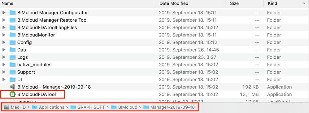

  1. Go to the installation folder of BIMcloud / BIMcloud Basic.
    By default the path is:  /Applications/GRAPHISOFT/BIMcloud/
  2. Select one of the installed BIMcloud components (either BIMcloud Manager or BIMcloud Server).
    By default the paths are :
    /Applications/GRAPHISOFT/BIMcloud/Manager-<Date>
    and
    /Applications/GRAPHISOFT/BIMcloud/Server-<Date>
    where <Date> is the date of installation in YYYY-MM-DD format.
  3. Select the Full Disk Access Tool and run the application by double clicking on it.
  4. Complete the Full Disk Access settings with the Full Disk Access Tool
