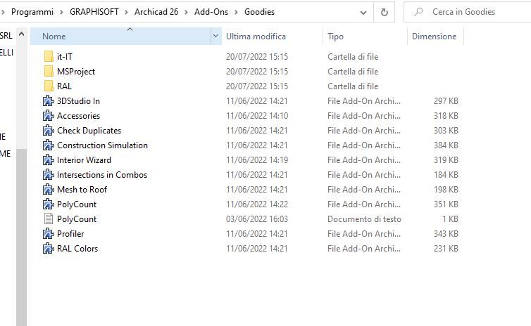

I've installed Goodies pack on my Archicad 26 but I can't see the Accessories it into the path design>extra design>accessories. Solution?

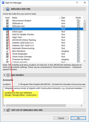

Check the Add-on Manager to see it is installed properly.
That will also tell yo the location of the commands in the menus.

I downloaded the Italian version as my Archicad, but when I check the Add-on Manager the files .apx are in english. What can I do?

If you don't, then can you show a screen shot of you Add-on manager.
I know. I downloaded the file . exe from that directory (https://Graphisoft.com/it/downloads/goodies/ac26)
the file is also contains "ITA" in the name 
