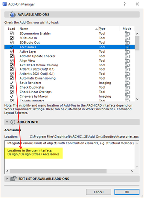

I've installed Goodies pack on my Archicad 26 but I can't see the Accessories it into the path design>extra design>accessories. Solution?

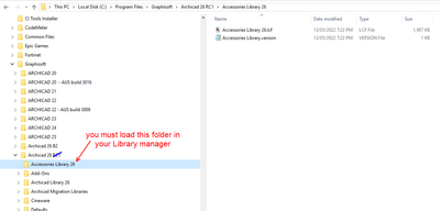

Did you load the accessory library?
It's a separate library from the main one, at least on v24

Check the Add-on Manager to see it is installed properly.
That will also tell yo the location of the commands in the menus.

YES, I load library
Antonio Greco
I downloaded the Italian version as my Archicad, but when I check the Add-on Manager the files .apx are in english. What can I do?
I guess un-install the English Goodies.
And then install the Italian ones.

So you have installed the USA goodies?
Do you have the commands in the menus?
If you do and you have no library objects, you must manually load the Accessories library that is located in the Program folder for Archicad.
If you don't, then can you show a screen shot of you Add-on manager.
