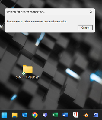

Just a bug heads up to the devs - not sure if this is the correct place to post.
I get a recurring prompt upon opening the ArchicadStarter as per the title and screen grabs below. Every time I select 'open project' or double click from the list BEFORE this prompt displays, the project will never open - it's a 100% occurrence. The cursor will just blue cycle until I force quit. If I cancel the prompt and then double-click open a project quickly it will open with no problem; if I wait a few more seconds until just before the same prompt shows up again, it will freeze again as above. Perhaps it's a Windows printer issue, but probably something GS should get onto as it disrupts the working day.
More recently a crash prompted the same message at the bugsplat window and it was unable to finish sending (or so it appeared) and I was unable to cancel out.
It 100% happens every time I start Archicad so I'm happy for a dev to get in touch and work through diagnostics for a solution.

Another bit of interesting behaviour to make you aware of while the problem is diagnosed:
It occurs when archicad closes too.
I received the message two times the instant a project was closed.
Notice there is no line under the AC startbar icon in the snip below, indicating it is closed, and yet the message popped up _just_ before the AC window closed.
This message only appears when AC is opened or closed.
No other applications trigger it, indicating an issue with AC's interaction with the printers list in win11, and possibly as simple as wanting to establish the connection to an offline default printer.

stoneunturned
Thanks Oleksandra,
I just did a general google and it turns out its an issue that's been occurring across a myriad of applications.
We were half way there with a solution. From the link below:
"Yep, exactly my experience - solved it by:
  • "Let Windows manage my default printer" OFF
  • "Default printer" MICROSOFT PRINT TO PDF"
My printer drivers were all up to date, but i had set my default printer to Adobe PDF to try and eliminate the need for a connection. When that failed to solve it, i didnt think to try Microsoft Print to PDF.
First open seems to be quicker, and without the popup message.
https://answers.microsoft.com/en-us/windows/forum/all/waiting-for-printer-connection/765f18ba-7632-4...

O_De Costa
Same occurring on my end. Doing regular editing, stretching wall reference lines, tweaking topo levels and had about 5 crashes in one day. Whenever 
the bug report dialog opens, the printer connection dialogue pops up with multiple dialogues opening up without my control. (See screen shot below). I am not sure the bug report was sent through or not. Because the only way to get pass these multiple prompts is to cancel them all independently. (Archicad 27: Build 5003)
