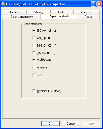

I have a DesignJet 500 and also have had problems recently. I also updated the printer driver which also caused problems.
The solution I found was that you cant print on ArchiCADs "Draft" print setting. The HP only has 3 settings whereas AC has 4 print settings. High, Medium or Low works but not Draft.
The other innovation with the HP driver is that you can now set standard paper sizes. In Australia we use ISO paper sizes but there are settings for other paper sizes including American, ANSI, etc. I found I had to get the printer Paper Standards settings to match exactly the sizes shown in AC for the printer to work. In other words one cant just adjust the sizes of paper in AC anymore. They have to be adjusted in both AC and in the Printer/Properties/Paper Standards for it to work.
I hope this may be of assistance.
AFAIK this was always the case?

Hi Djordje,
I used to be able change the paper size in AC and it would automatically change the paper sizes in the printer properties.
But now if the paper standards arent set in the Printer Properties it wont change just from AC Print dialogue box.
I dont remember having the Paper Standards in the old printer setup but they may have been there??? I dont have the old printer driver anymore to verify.
