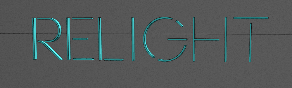

Hi everybody. I´ve made this logo in profile manager and every time I try to change surface or height I get this error message that says "Polygon is degenerated (VT-1)". Does anyone know how I can fix this? Is this maybe because the letters of the logo in the complex profile aren´t attached to each other? Thanks

Yes, they should be connected! ArhiCAD is not a logo program so it is easier to use CorelDRAW?

Break it down in to a profile for each letter to see which of the fills is the culprit. You probably have some self intersecting curve or the likes going on.

I would look closely at the "R" where there may be a problem with the tangential connections. All the other shapes seem to be straightforward circular arcs and lines.
