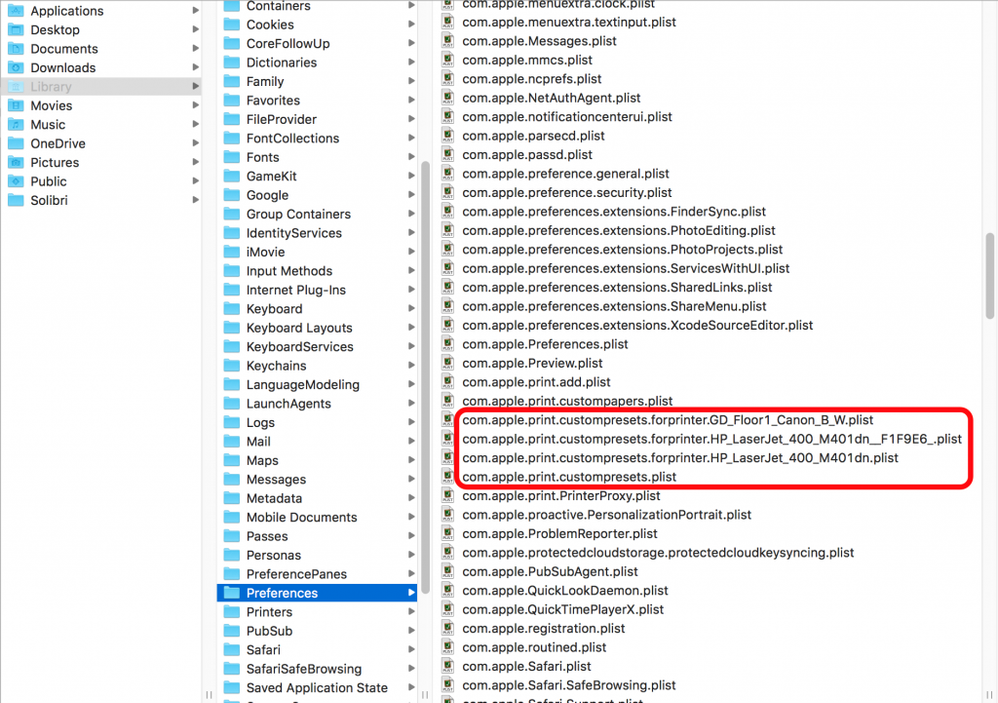

This issue is related to the printing preferences created and stored by the OS. Based on this discussion on Apple Support Communities, deleting the presets helps. To do that go to ‘System drive/Users/<username>/Library/Preferences’ folder and delete files named com.apple.print.custompresets.plist or com.apple.print.custompresets.forprinter.<printer name>.plist.
No Library Folder? The Library folder within the userhome folder is hidden by default. To browse to the ~/Library folder:
  • In Finder choose Go, Go To Folder
  • Type ~/Library
  • Click go to navigate to the Library folder
  • Or simply press option (alt) when the Go menu is open in Finder to show Library on the list
