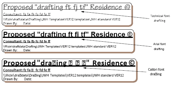

Does anyone else out there use the Calibri font.
We are having problems with certain letter combinations in lower case only not printing in the PDF.
They are fine on screen in Archicad and the layout book.
Just a problem when published or printed to PDF - even with other PDF converters.
Only happens in version 11 & 12.
Version 10 is fine.
See the attached image.
Seems that "ft" and some other letter combinations do not print - they appear as a square with a question mark in it.

I think it's an issue with your copy of this particular font. The letter combinations are "ligatures" (combinations where certain characters overprint more or less, horizontally).
If I remember correctly, it's a Microsoft font, installed with MS Office. Try thrashing the font and then re-install MSOffice! And then restart. If necessary you may have to upgrade Office or search the Net for a newer version of the font.

I'm currently building a template for a client who wants to use Cailibri as the main font, and can confirm the same problem on AC12, Vista.
I think Thomas is right about the overlap because inserting even the tiniest space (eg. a space between f and t with a height of just 0.1mm) will get rid of the problem.
Annoying workaround, but a workaround, nonetheless.

This is a known issue with font types that use ligature - when two characters merge for better readability. http://en.wikipedia.org/wiki/Typographic_ligature The "Calibri" and "Symbol" fonts use ligature.
The problem is in the font, but the manufacturer of the PDF engine that we license promised a workaround in one of their updates. So we might be able to fix this at a later time, if the Font does not get fixed.
It is not possible to turn off ligature, but we found that on Windows XP it only occurs when asian fonts are enabled (Control Panel -> Regional and Language Options -> Languages -> Install files for East Asian languages)
We found that disabling this option turns off ligature in Calibri font, so that is a workaround on XP.
