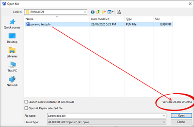

File size seems reasonable.
But if it was recovered by piecing together deleted data from your hard drive, it may not be a complete file - hence it wont open.
If you open Archicad and browse for the file, it will show you the version it was created in.
If it show nothing or "0" then I am afraid it is a corrupt file.
You could try your local Archicad support people.
But I am not sure if they can or would be willing to help unless you have a service agreement with them (or maybe if you have an educational license they will be willing to help).
This link will hopefully give you your local support if you don't know who they are ... https://graphisoft.com/contact-us
