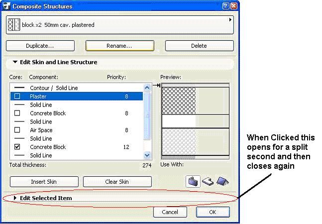

We select element from the list and then click edit skin and lines structure, once we are done we click 'edit selected item' to expand the list. As soon as we do it expands the editable items list for a split second and then hides it again?
I have clicked the check for updates and we are running the most recent version of the application according to your website. We have your software installed on 30 – 50 machines. This is happening on half of our machines? I have tried uninstalling and reinstalling this appears to make no difference. We are running Windows XP SP2 on P4 3Ghz all the same specification so hardware shouldn't be the issue. Image attached shows the issue
[/img]

This appears to be a screen resolution issue. This window shown below seems to have some intelligence, if there isn't enough space on the screen for it to expand it will automatically close. The machines that we were having issues on the users were running their machines at something very low like 800*600 or 1024*768. Once the Screen resolution was changed in WindowsXP the panel functions as it is expected to.
The window has the intelligence to not expand if the resolution isn't big enough but doesn't inform the user??

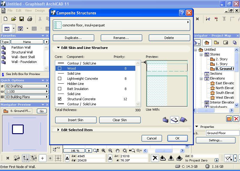

I just switched my left monitor to 800 x 600 to verify that indeed, the Composites Dialog's 'edit selected item' panel cannot be displayed at that resolution. This is not a bug...a variety of other dialogs (Work Environment for one) cannot fit vertically at that ancient resolution.
There is an error message - but it is subtle: you'll notice that after clicking on 'Edit Selected Item', it turns gray, meaning that it cannot be selected. Personally, I see no reason for GS more than any other manuf to provide actual error handling for below-spec resolutions...but I suppose there could be a single message when AC starts up warning that "some dialogs will not be visible at the current resolution". I'll throw that suggestion into the system. 😉
