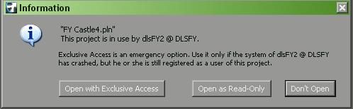

while I am working...sudenly something happens I dont know what...but I can`t find the building in 3d mode and I cant use the saves!!and I receive this error!!
10 REPLIES 10
and oh yeah let`s not forget that no matter my answer to that error the program crashes!! !!I have restarted the same project three times!!!
Try starting a new file and merging the problem file into it.

Is it only that one project? Or all projects?

it`s all projects the same...

Are these on a network server or on a local machine? If they are on a network, what network OS are you using?

it`s on a local machine...
"Try starting a new file and merging the problem file into it."
OKY I really don`t understand... as in I should open a new project and put the projects that don`t work into it???

Start Archicad.
Hold the ALT key, go to File, choose New and reset all.
When Archicad restarts, merge in the file that does not work.

Hey thanks to all that "merging" thing solved my problem... now I can continue my project!!thanks again!!PEACE!!
