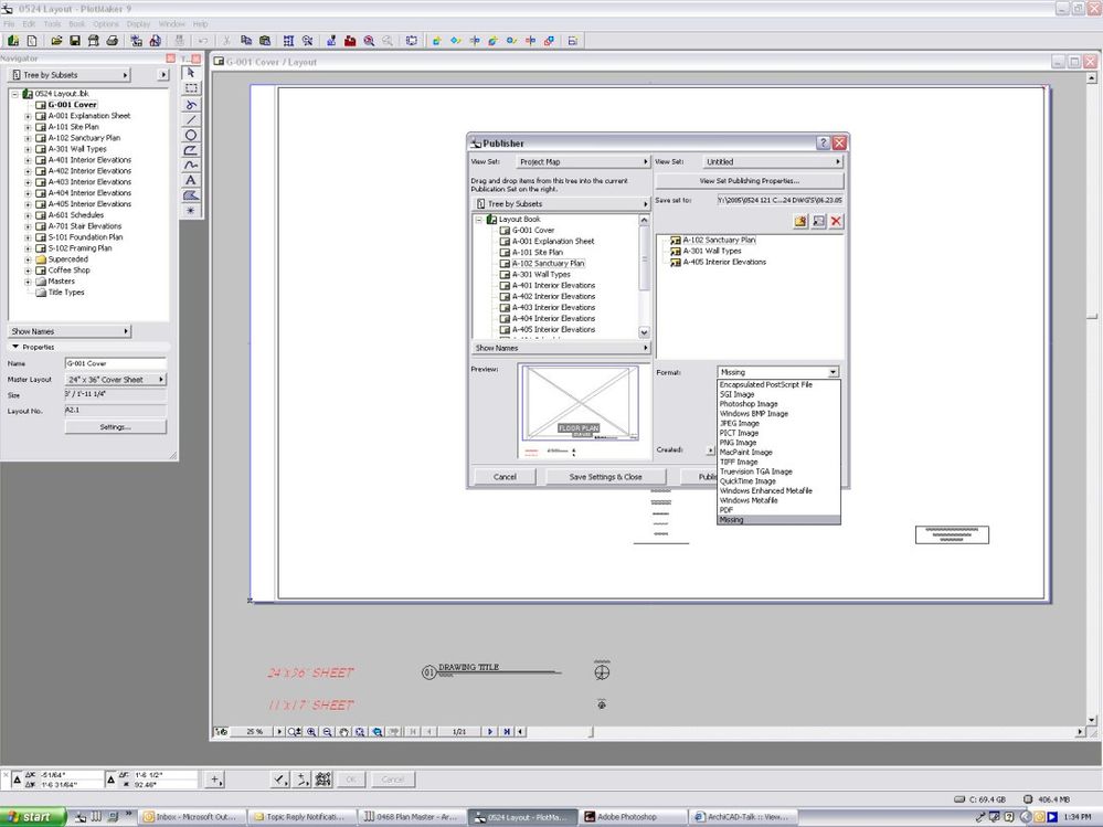

I am currently using Archicad 9; When in plotmaker I go to publisher to create a dwg file. In the past I have been able to create a dwg file successfully, however now the format dialouge box is missing the option to create a dwg file.
Does anyone have any answers or suggestions?

Could you post a screen shot?

Here is the screen shot

You may need to check your installation. It should be there.
Look in ..../Graphisoft/Archicad 9/Add-ons/Import-Export. There should be a file called DXF-DWG In-Out.

I deleted my add-ons folder and pasted a new one. Everything works now.
