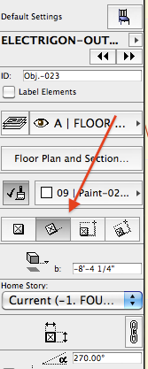

Thanks a ton. That is a nice object. What I am hoping for is a 2d symbol (outlet or switch) what will automatically align perpendicular to the wall when placed. In other words, not have to rotate the object for the respective walls in a room.

Erich
Change your method of insertion, then the rotation can be done all in one go.
