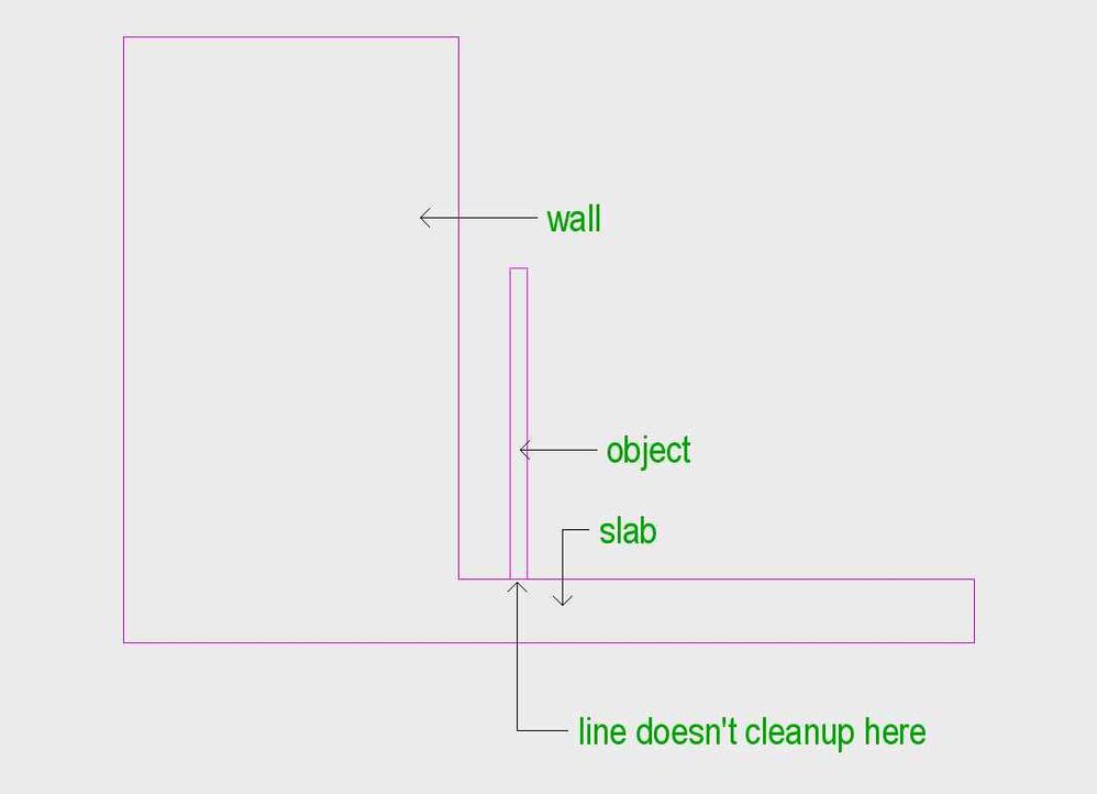

I can never get an object to cleanup at a 3D intersection with a slab in the same way a wall does. ( see attached elevation)
Is it possible?
Cheers John

I think John is refering to cleaning up in elevation not section.
If he is I have not found any way to make an object clean
up with a wall, slab, or roof except by creating masking prism_ s
in the object's 3D script. These masking prism_ s are 0.002" thick
with all masking values set to 8 and cover the joint between the object
and archicad tool object which don't have a user option to hide edges.
I do this often and wish a more honerable way to do this "cleaning up".

thanks Peter I was just about to say I was refering to elevation views
Now I have some confirmation that it doesnt work I'll have to put it into the wish list (unless a Moderator would like to move it there for me?)

John,
I've been meaning to do this for weeks.
I have had the same problem and the same wish.
Now a year later I have some information.
Both the XWALL command and the BWALL command will
cleanup with slabs and walls with some strange limitations.
Glad to discuss it if you are still interested.
