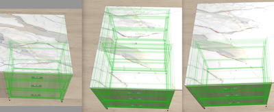

How do you fix this line, before you could have them joining and there was no lines.  Also is there any way of having several knobs, handles, turns or what ever anyone calls them.  I should not, with this new tool copy pasting drawers over doors.  I was in version 19 waiting for some good improvements, and the video is false it says it parametric.  I still have to copy separate cabinets multiples on top of each other to have many handles, doors, knobs, or what ever they should be called.  Has you can see the best way to do this was to create the cabinet, off to the side explode it into a morph drag the knob of desired back over, so not BIM at all.

You can add a side panel to one of your cabinets and extend it to the rear to match depth of other cabinet.
Then extend side of benchtop to overhang the panel.
It seems you can configure doors and drawers for each segment, and the position of the handle can be set for each segment.
But the handle type is global and can't be set for each panel as far as I can see.
