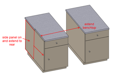

2022-03-25 04:36 AM - edited 2022-03-25 04:37 AM
You can add a side panel to one of your cabinets and extend it to the rear to match depth of other cabinet.
Then extend side of benchtop to overhang the panel.
It seems you can configure doors and drawers for each segment, and the position of the handle can be set for each segment.
But the handle type is global and can't be set for each panel as far as I can see.

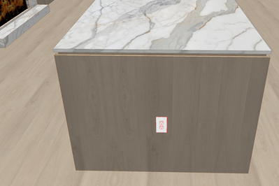

Thank You Barry!
The image is to show this is what I wanted to achieve for the ends, were I am pleased I don't have to do slabs, walls, or what ever to get this very nice look. The marble counter top is for sure a slab, the more I do the custom work its much easier to do a slab just like you would in the real world cut it and place. For me I do not have a problem for that, so the 3/4" is the counter top. At one time I was using 2 slabs, (1) for the wood which was recessed in all the way around the island at 3/4" then another slab for the marble top itself. Maybe going back to that way, one time I used a composite with 3/4" wood, 3/4" marble but then I had to do the SEO. Were that made more sense, but its so much efficient and faster to offset 2 slabs, then modeling around, (magic wand use that like its candy) but if it needs a chamfer or fillet then I have to do that and use the SEO. It would be nice the slab could have segments like the newer tools and fillet, chamfer, or profile edge. I said that to say for new users, there are many ways of doing something, but one way is for sure faster than the rest. The most important part if you don't know the software you can't go anywhere. So see the image, it shows it does what I want for the ends. But I will post what you showed, and it still does not work.

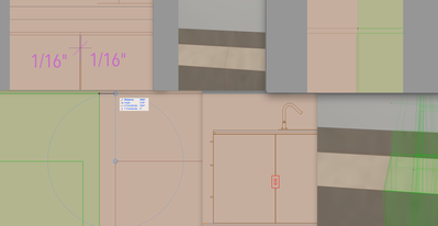

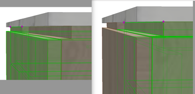

2022-03-25 05:58 PM
As you can see, I measured and it showed 3/64" played with it many times; they should meet or need a magenta (hotspot) so you can move that point in any view. I work, plan, section, elevation, and a lot of 3D that should be there to do just that adjust as you work. Also, I extended it and turned off the other cabinet as your image is showing the panel but that is just another non-real world work around, that being said, if both sides was identical it would not work because I can not mirror it runs into each other. But for the knobs, handles, turning or pull objects, I would be even fine if that was another object that would be a stain or associative as the railing tool. Again when Graphisoft introduce that new feature named and called associative everyone in that place should have said wow amazing lets associative all objects. So when I raise the ceiling BAM! fixtures move with that, same for walls lets move the electrical outlets, or switches, let's Build something great and awesome. But thats a whole other topic, so yes that all being said, will just have to rethink, or just go open up a Archicad 24 and model the kitchen the way it worked with those tools and bring into Archicad 25.

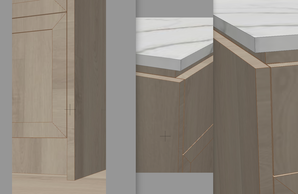

2022-03-25 06:08 PM
Barry,
After reviewing it another time, I could see from your comments I was able to get it much closer and I left the top cabinet counter top set back for clarity.
2022-03-25 06:13 PM
Barry, Thanks again for the reply. Finally was able to achieve the eye candy I wanted and an acceptable CD's to print out, but still its just another work around and a tool that does not do what it says it can do. So if you look at the object I still can not mirror it and make it work the way it should.
