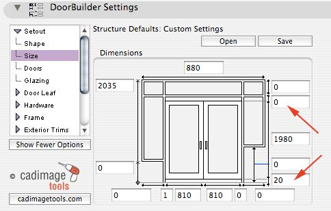

I'm trying to put a 20mm air gap underneath Cadimage doors in ArchiCAD 17 but it puts a piece of frame there.
