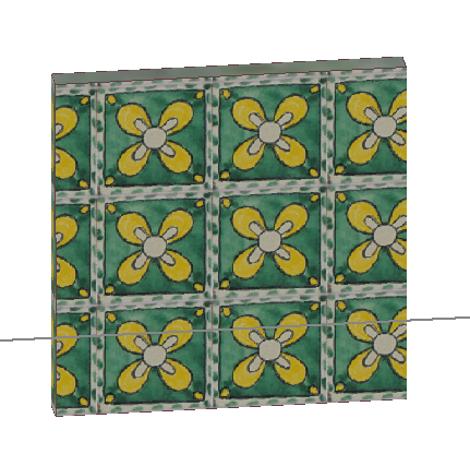

OK, here's the code I tried:
	DEFINE TEXTURE "tilePattern" txtName,
		txScale, tyScale,
		0, 0
	txtNum = IND(TEXTURE, "tilePattern")
	DEFINE MATERIAL "tilePattern" 24,
		1, 1, 	1, ! RBG Color
		0, 61, txtNum
	matlNum = IND(MATERIAL, "tilePattern")
! Draw Tile
	cPRISM_ 0, 0, matlNum,
				 5, ZZYZX,
			0, 0,     15,
			A, 0,     15,
			A, B,     15,
			0, B,     15,
			0, 0,     -1
! Set Texture Origin
	VERT 	0,		B,		0		! Origin
	VERT 	1, 		B, 		0		! X Direction
	VERT	 0, 		1,		0		! Y Direction
	VERT 	0, 		B,		1		! Z Direction
	COOR 2, 1, 2, 3, 4
	BODY -1
The material is definitely not starting at 0,0,0 (the lower left corner) like it's supposed to be,
Any other ideas? Or did I code something wrong?

Frank Beister
Hello Tom.
I can not test it in the moment, but I think, your vertices are wrong.
If it should be at 0/0/0, why is there a B inside? The direction of he axis ...
is independent of the origin. They show the direction from local, not from texture origin, pointed by the 1st VERT. Your "direction" should be 1/0/0, 0/1/0 and 0/0/1.
I think your VERT-block should work with
   VERT    0,      0,      0      ! Origin
   VERT    1,       0,       0      ! X Direction
   VERT    0,       0,      1      ! Z Direction
You can do some transformations before the VERT commands to bring origin and orientation of your coordinate system in the position you want.
TomWaltz
The intention of the "B" value was to move the origin a distance (B) in the Y-direction.
I thought that if my origin was 0,B,0 and the vector was 0,0,0, the material would be tilted.

Frank Beister
Tom, if it was not clearifying, you can send me the object and the pict. Would be much easier for me to help.

! Set Texture Origin New
	COOR 2+256, 1, 2, 3, 4  ! 256 is local coordinate system
	BODY -1
