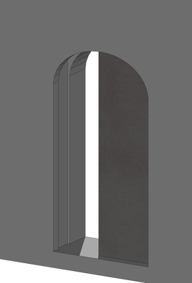

For a project need to make a pocket door with an arched hole top ( like the one in the screenshot).
Of course there are no standard Archicad solutions, at least in the library we are using in the office ( Archicad 25 INT ).
Does anyone have an idea of how this could be done. It would be better if the element were a door and not an object.

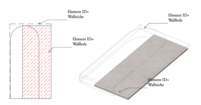

Use 3 slabs:
1/ Door
2/ Opening (with element Id Wallhol)
3/ Rectangle space for the door in the wall (with element id Wallniche).
Select all 3 and save is as a door (File/library and objects/save selection as/ door)
Place it in the wall.

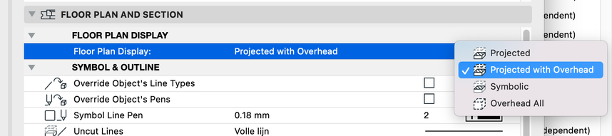

Use projected with overhead for 2d display.

Empty arched opening in the actual wall and a 2nd 0 mm thickness wall to host the sliding door (which will be rectangular anyway).

Use 3 slabs:
1/ Door
