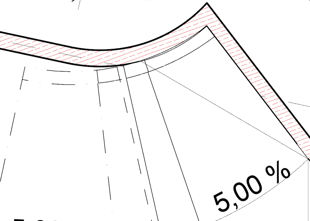

I need to create a proper curved ramp (I've been using ArchiCAD native object), but I am not able to make it behave as I want. What I mean is I am not able to model curve properly. How should I go with it?

See if the shell tool will do what you want.
If not, I use a mesh to get the exact rise I need, the copy it down the thickness of the ramp, and do a solid element operation to clean it up
