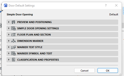

i am having the same problem with the door tool.  being new to Archicad 25.  can someone explain how i add the object library to the door tool. unlike the other object tools there are options to pick from on the left.  all i get is the simple door opening
thanks for any help you can give me
Solution
This should help.
I am not really sure why we are allowed to close the panel on the left.
REL-3
thank you.  that worked
