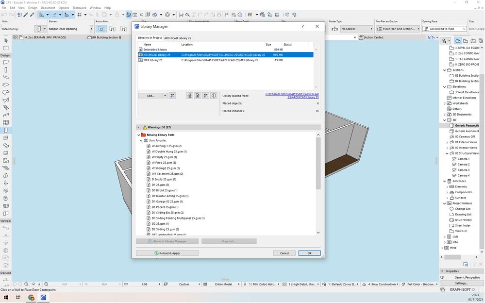

Greetings!
I recently installed Archicad 25 and just started working on a new project. I noticed, however, that some library parts appear to be missing. There no doors or ramps, for instance. The Library Manager states that the Archicad Library 25 is installed, but below it there is a list of missing parts. In the Library Manager Archicad Library 25 tab I can actually visualize the missing parts, so I'm not really sure what is going on.
I already reinstalled Archicad 25, but to no avail, and I am at a loss of what to do. Can anyone help me find a solution for this?
I'm attaching a couple of images too.
Cheers,
Rafael Ardjomand

They are not missing library parts as such, your libraries are loaded just fine.
They are missing library parts used in the 'Favourites'.
Your favourites are set to use library parts that are no longer in your loaded libraries.
I am not sure why this is happening on a new project unless you are using your own template.
The favourites in that template are looking for library parts in a different library.
But clearly they show they are looking for '25' library parts, and you have the 25 library loaded.
So I am wondering if you have managed to swap language versions, form INT to USA - as the doors and windows in those libraries are different.

US template with the INT library.
RafaelMA
Thank you, @Barry Kelly, you are absolutely right!
Yes, I'm using a template I downloaded, but it was supposed to be a template for Archicad 25. I'm not sure about the languages versions, though. I suppose @Lingwisyer is correct, but I really don't understand enough about these technical differences  in the software yet.
Thank you all so much!!!
Yes, the template you downloaded was probably made in a language version different to what you have installed.
You can 'Edit' each favourite and find the correct library part.
Or if you don't use the favourites, you can simply delete them - either all of them of just the ones that are missing.

3rd party templates are often adjusted for their local standards such as naming conventions, story structure, page sizes, dimensions of predefined composites and profiles, etc so I would advise that you use a template from a local source, especially if you are new to the program, in order to reduce future headaches. Or if that template is a local one, can you use the use the localised AC version, AC25 POR, or download and load the US object library?
