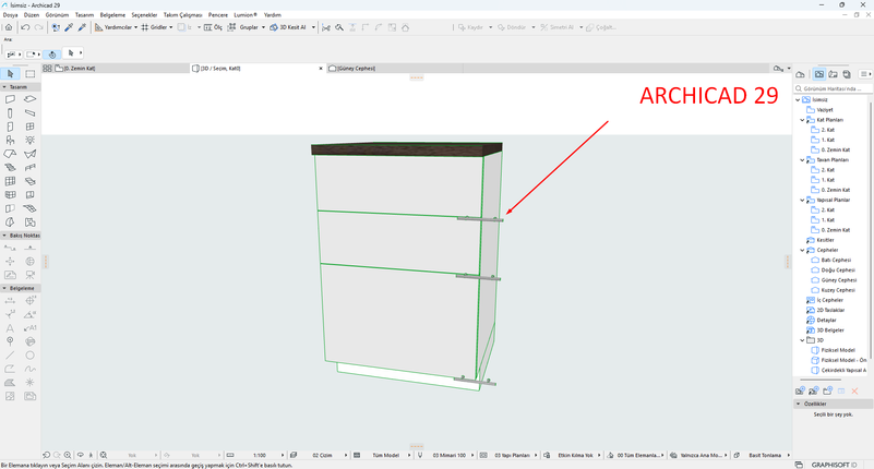

Archicad 29 Kitchen Cabinets vs Archicad 28 Kitchen Cabinets. Why?
It was said that improvements had been made to kitchen objects in Archicad 29.
When I added a kitchen cabinet to the project I was working on in Archicad 29, I noticed that the handles were in the wrong position. When I went into the handle position settings, I saw that the distances here were completely wrong. The same problem occurs when I open the file without using any workspace.

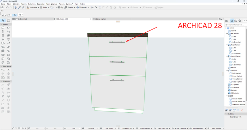

However, when I added the same kitchen cabinet in Archicad 28 without making any adjustments, I observed that there were no issues. I didn't even need to change a single setting for the handles.
Why?

I didn't work in 28, but yes, in 29. there seems to be some frustrating parameter defaults. And cumbersome adjustments to fix them.

I've reported this problem in Technology preview.
In AC29, the logic for handles settings and as well bottom "legs" was chnaged to be better in terms of changing size of the whole cabinet.
As already mentioned, this is just that someone set wrong default number so it looks like this.
Do you have the last library update for Archicad 29?
