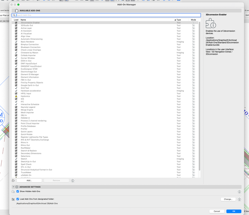

Digging deeper, we compared their add-on manager to mine. My add-on manager shows the hydronics add-on loaded fine. Theirs reports a < ! >; but their applications folder contains the add-on. It does look like their add-on is a version newer than mine.

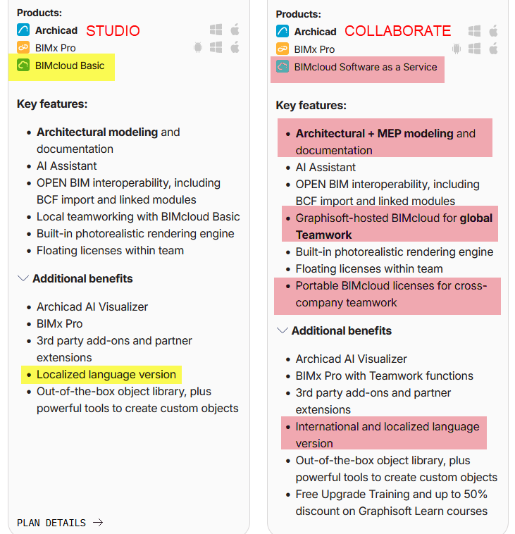

Do the others have Archicad Studio licenses by any chance rather than Collaboration?
Patrick M
oh, is the MEP exclusive? I don't know about their license pool... they are on bimcloud basic, so maybe they aren't updated
they had to have access to those tools at some point.
I guess I'll be swapping all the objects out for them... there goes my weekend
No, Studio does not have MEP.
Here are the key differences.
