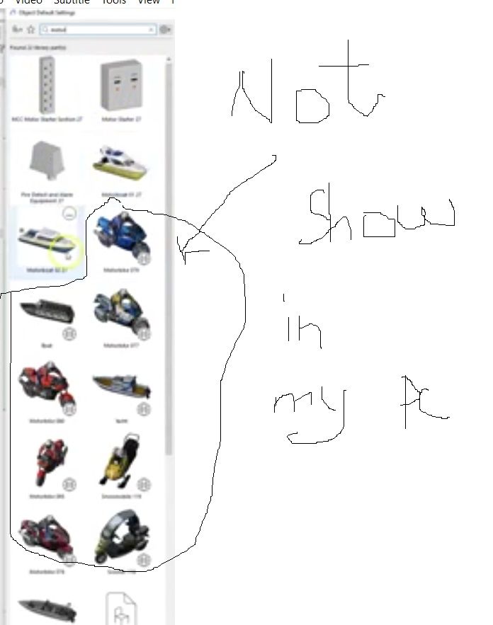

My teacher shown me that there are a lot of motorbike can be download (as shown in clouded figure below).
However, in my PC, doesn't show those motorbike.
Is my download setting went wrong ?
Is it possible to advise how I can modify my setting in order  to show those download-able motorbike ?

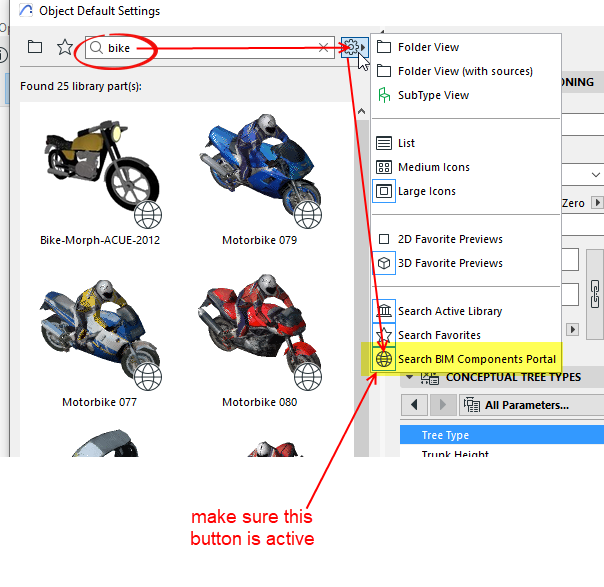

In the "Gear" Icon check "Search BIM Components Portal" and they'll show up.

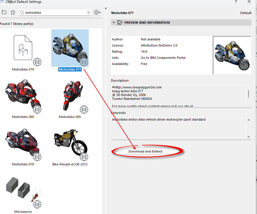

When you select that object, on the right hand side you should see a 'Download' button

Once you have types something in the search bar, go to settings and make sure it is searching the BIM Components Portal.

I have turned the button.  However, I still haven't find the object I need.
