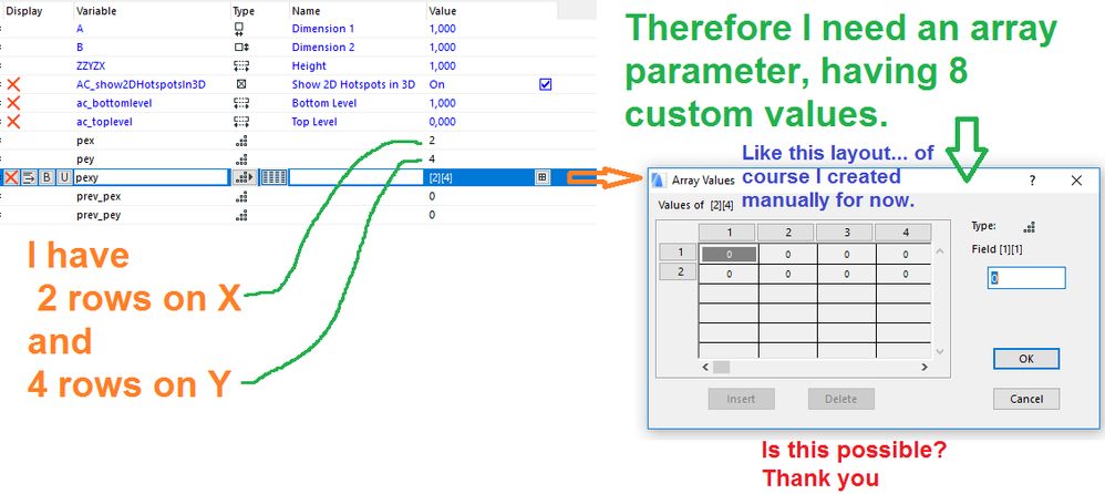

Hi everyone,
Please see attached.
Any help = will be appreciated.
Thank you.
Daniel
Sincerely,
Daniel

Without knowing what it is you're trying to achieve, it is impossible to give proper help. However, what you've already created should do the trick: just refer to your array parameter in your script.

Hello,
You can expand the array size for example in the master script, but
it would be useful to know what is the purpose for this.
for yy=1 to pey
	parameters pexy[yy][1]= yy!--rows
next yy
for xx=1 to pex
	parameters pexy[1][xx]= xx!--columns
next xx

Here is the purpose of having that array parameter - and I think I did It. I need the user to have the possibility to change the Glass Panels based on he's needs, if make sense.
