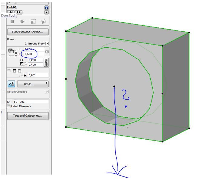

Florian:
In the Object's 3D Script you will need to add an
AddZ command with the value of 1/2 the height of the Object (whether that is a fixed value or a parameter), probably at the top of the script.
David
