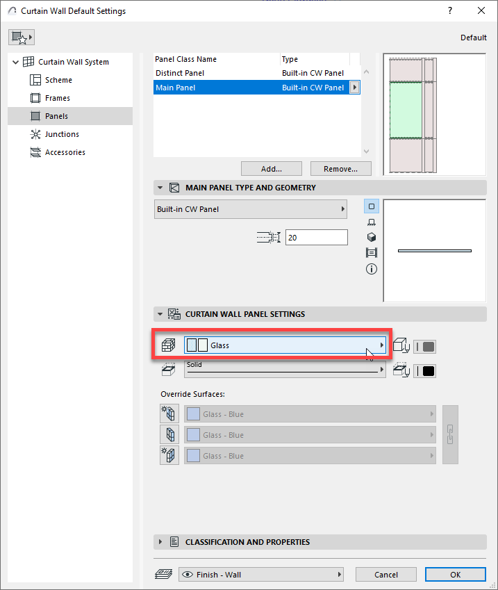

I have a pop up warning that a material is missing. How do I find the missing material?

Select the Curtain Wall, and check the Building Material field in the "Curtain Wall Panel Settings" panel of the Settings Dialog's Panels page.
I suspect it is missing, so you should set it to a Building Material that is available in your Project File.

Thanks. How did you know it was in the curtain wall?
The error message talks about the "Built-in CW Panel.gsm" file. In this instance, CW means Curtain Wall. So, I knew that this is a Library Part that is used as a Curtain Wall Panel, so I knew I needed to look in that panel of that Dialog (a Curtain Wall is a hierarchical element type, where you define the reference line, length, height, etc. of the Curtain Wall, and Archicad generates it and its sub-elements - Frames, Panels, etc. - using Library Parts - those files with the GSM extension, where GSM stands for Graphic SyMbol, if I am not mistaken).
Also, the error message said a Building Material is missing so I knew one way this can happen is when your setting is referencing a Building Material attribute that is for some reason not available in the Project File (the Building Material attribute may have been deleted earlier.)

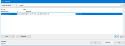

JeffH
if you copy the bottom code that is between the "( | " and " ) "..You can paste that into Find and select for All Types.  you just have to add the Criteria "Tag (Attributes) " under the Add>IFC Properties panel.
It will select the exact element in question.
