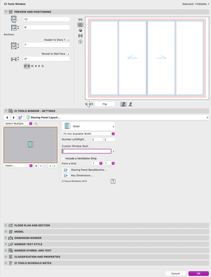

Can someone please tell me how to change the direction of a surface slider?
I want the two center panels to be opening away from each other.
I am really struggling with the CI tools windows and doors. I find them to be needlessly and overly complicated. There seems to be a thousand options for any conceivable configuration, but something as simple as changing the direction of a slider I cannot figure out. I'm sure it's a simple fix but I've spent an embarrassing amount of time on this and cannot find the solution.
Thank you
Solved! Go to Solution.

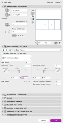

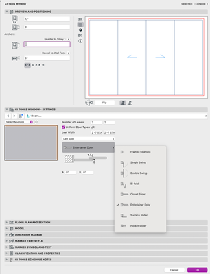

so if it has to be a window, you can make it a door, use an entertainer door as the operation, with 2 leaves on each side. You can do the same thing using the c/i door, rather than the window inserting a door.
using c/i door instead of window:
or, using a window as a window (without door operation):

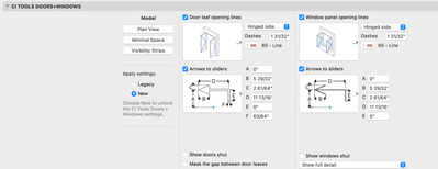

if you have jumped all those hoops, and it's just the arrows showing incorrectly, make sure all your window settings are "By MVO", then check this in your MVO settings (hinge vs opening setting):
